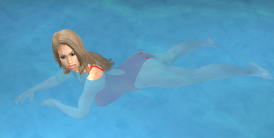

I am working on a few animations, which will be included as special assets for makehuman version II. Therefore I changed the floor, which was mainly used for debugging of walking animations.
It can be resized now and also made thicker. When transparent the floor is useful to simulate water. So one can create an origin for a later animation to be below the floor. It is not yet 100% but the animation itself looks pretty good. A few different skyboxes and floors will be available as assets as well.
floor as water

This is mighty nice in terms of the way she moves through the water, the way the bones of the rig move. Very realistic, indeed.
It is really going to be great when we can animate the hair and the water, but those things are probably outside the scope of current developement and best left to being done in Blender. Hair and water motion needs a lot of compute to get the physics right, and most folks are not going to have the hardware which is powerful enough to pull that off. And then there is the ray tracing thing, which needs even more compute and a GPU that can do the traces.

Well the water surface is just for determination of the origin of an animation. It is not meant to be a new Blender. Maybe you remember that there is mostly a "feet on ground" checkbox for the exporters. For swimming this results in an odd position (it is not really feet on ground, it is more or less the lowest vertex). I will try to have at least one pipeline to export to Godot/Unity/Unreal via glTF without the need of using Blender in between. That is e.g. the reason why I switched to more common textures like metal-roughness and AO map at the moment, these ones are used in game-engines. AO map in Blender does not make too much sense, at least not in cycles.
