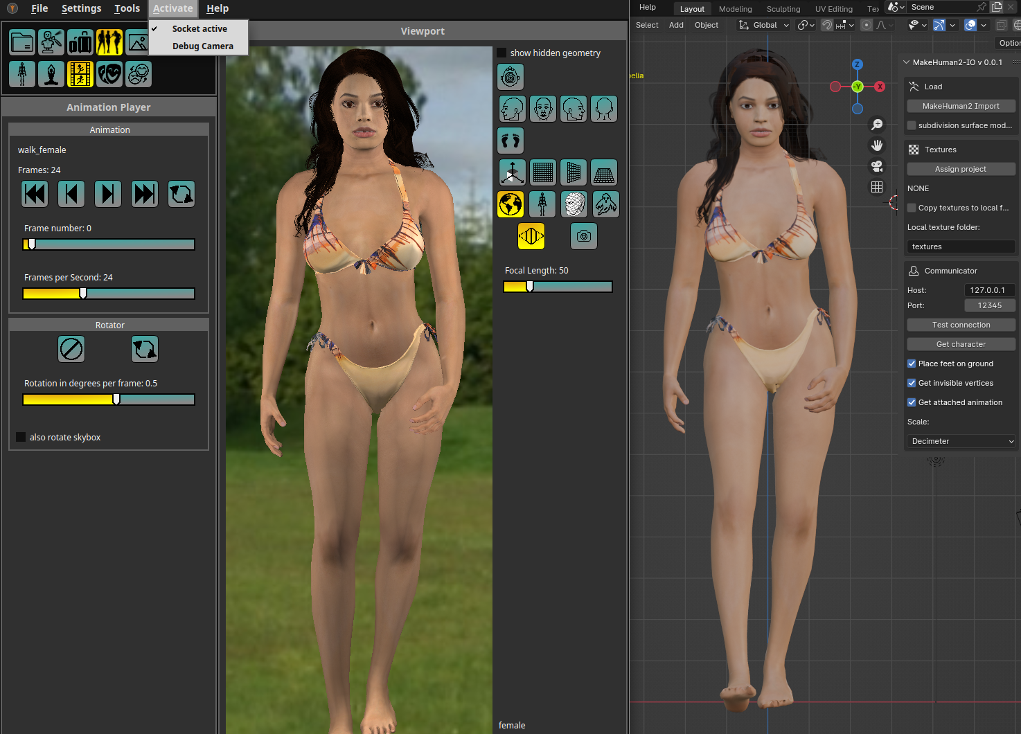

first steps with socket communicator
Meanwhile I created a socket communication. Internally it uses the exact same way as the mh2b format. There is no difference reading a file or a bytestream ;)
The character is transported using two calls, one for a JSON description and one for the binary buffers (the concept glTF uses as well).

Postby RobBaer » Mon Jan 27, 2025 11:35 pm
Very nice. Your image also gives us some sense of how your environmental lighting is working, I guess. It didn't seem to move into Blender. Intentional?
Posts: 1238
Postby punkduck » Sun Feb 02, 2025 8:57 pm
At the moment the socket is only a second way to import the character. There will be a few more features. But not everything makes sense. For example one can import different characters or replace an existing one. So a "keep in sync" would not always be, what is wanted. There is also a problem with definition, where the textures should be in the end. When one saves something from blender, paths should be relative etc.
Blender Eevee should give similar results, yes.

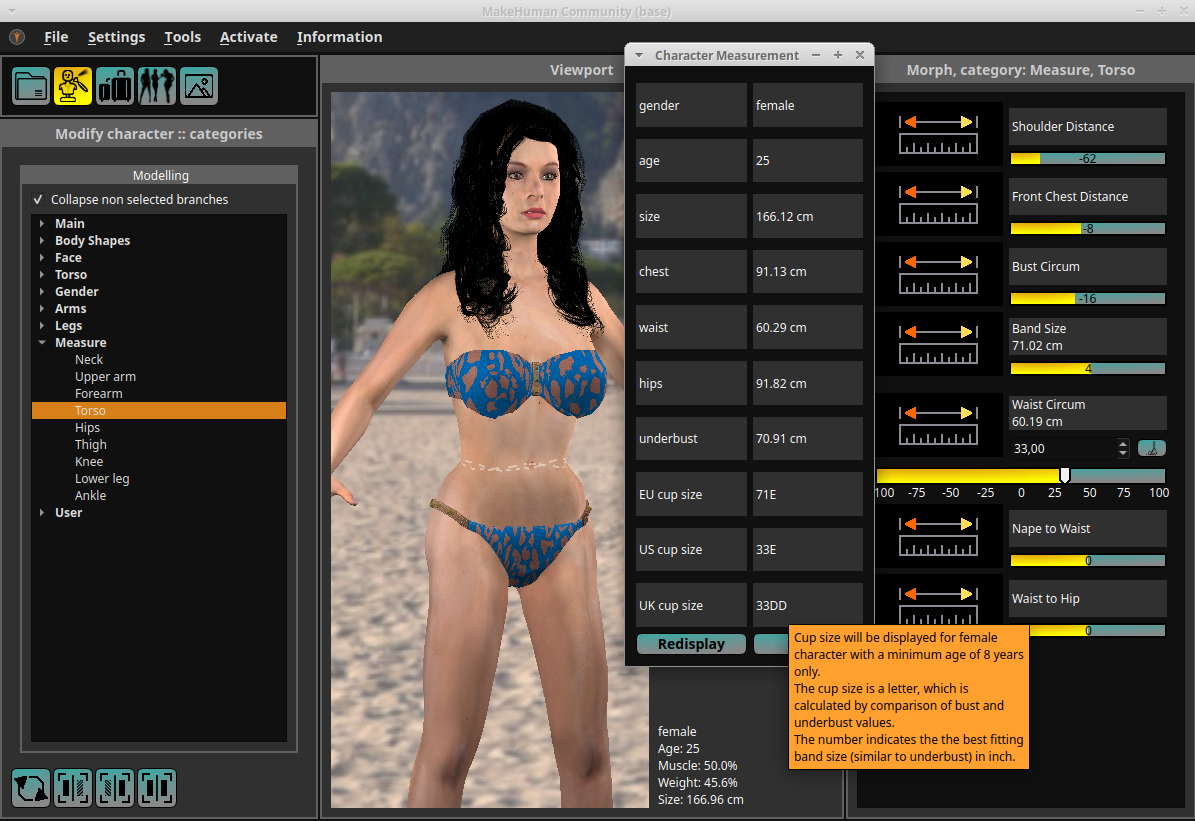

In between I did these measurement targets, which create a visual representation inside makehuman. It is an OpenGL overlay of lines always in foreground. The vertices are now defined in the target description and will be no longer inside program code. I found some unused code to calculate cup sizes. Well, so I decided to generate a character info, with a bunch of values as shown in the image below. As long as you have a female older than 8 (that's what I found in the internet, although usually it starts with 11 to 14) cup sizes are calculated. Size are from AA to O, last one would be boobs-on-a-stick, because of bust/underbust ratio calculation. Today I started with randomization.
measurement and information

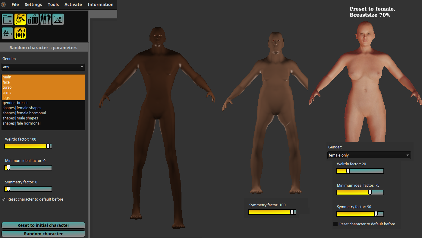

Anyway I tried with the random-generator meanwhile. One can really create creepy characters, like the one on the left side. With symmetry some look rather cute. And when I change them only a little and set ideal factor (which is proportions) to higher value + start with a character (here 100% female, breastsize= +50%), and NO reset to standard it seems to be quite okay.
from weirdos to non-weirdos

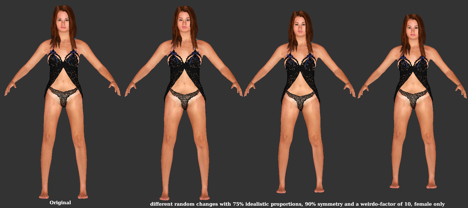

So without reset, now one can use an existing character. So I loaded Leska and dressed her with elvs nice undies.
I change her by approx 15% and 75% ideal, 90% symmetric and "female only". Similar characters will appear.
changing an existent character
Last test is with the same values, face only.
change the face only
The idea would be to call these functions by socket from blender as well. I think this way is more helpful than the old randomizer.
(most of the rules (like pregnancy only for females) and which groups are changed are configured in the base.json file to allow similar features with other names on different characters / meshes in the future)

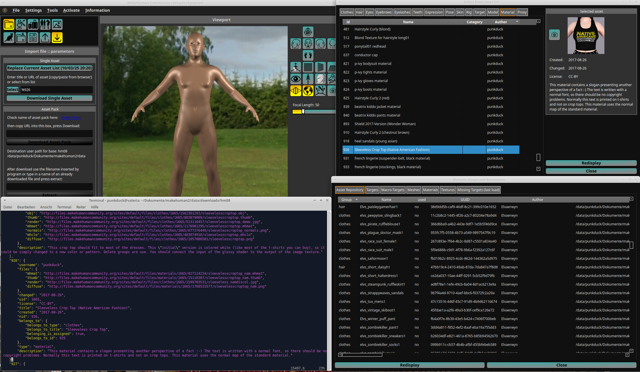

At the moment I create an asset downloader for single assets for the new version (there is an asset pack option as well, but it is partly disabled not to ruin existent assets).
This downloader itself tries to work with only the file assets.json ... and since that file is loaded to a download folder of makehuman itself, it is easy to understand what it does. This is more or less the same as in old version.
I try to avoid too much internet traffic, so no images are loaded without demand. One can press the camera button, which only loads the thumbnail if needed. One can even copy the URL or title in name field for download. Because when I check on the www-page and use makehuman and then are interested to get an asset, it would be more or less the simplest way without searching in the asset.json. Well there are a few exceptions where that does NOT work, but mostly it does.
At least one can always select the asset from the list, it seems to work for most of it already.
There are still 2 exceptions:
  • targets go to the user target folder correctly, a subfolder of the category is created or used, but the category and target json files are not yet created (after restart it works). Deleting a user target also creates problems. This I need to add anyway.
  • for materials it is simply not yet implemented. I hope the program will find the destination folder. The repository is in a sqlite database, so it could be easy if the names/titles are matching.
At the moment it is limited to specific file types like "diffuse" etc. Maybe I have to add some others. Maybe I also create metallic-roughness maps from existent single maps ...
I also need to avoid "huge thumbnails" (resize them before I put them to the file-system maybe to shorten time when asset page is created). For the worst case I need to create a manual possibility where to put the files. I guess I will add search patterns on top of the columns. These are the next ideas.
asset downloader in progress
There are still bugs, just learnt from Wolgade that my disabling of the buttons, if the asset,json was not there did not change after download ... but of course after restart. Fixed that just 20 minutes ago :?
