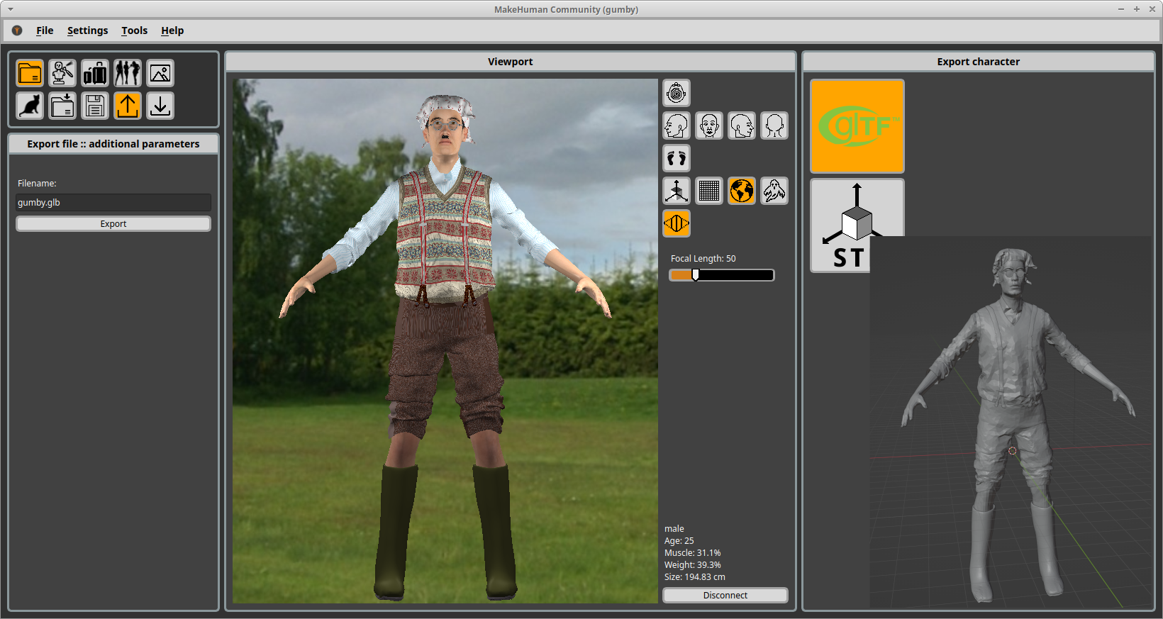

And here is a mesh exported with new glTF (glb, binary format), no smoothing ("vertex-normals") yet and no textures added.
That is the result after a week. And it was mostly understanding the way they do it.
The technique is pretty similar to the openGL format we use inside. We have positions, UV-positions, vertex-normals + indexes for all used triangles.
I did not even have to organize extra buffers ...
glTF is just a JSON-blob for the description including lengths and offsets + all buffers appended byte by byte as a second blob. (blob = binary large object). For a quick test was okay, but the buffers I need to change in the end, because hidden geometry is also exported at the moment. And then one also does not need positions and UV positions of unused vertices.
Yes glTF ,... I promised that to Tomcat a time ago ;)
gltf export + screenshot in Blender

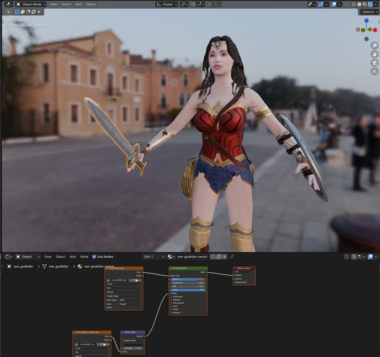

Meanwhile I am working on two export/import systems the same time. One is glTF and second one is a special blender method. The blender one will work with JSON + "value buffers" and the buffer technique rather identical to glTF.
Why not 100% identical?
  • glTF is triangle based, so the exported geometry is often different to the original one.
  • Afaik glTF is limitied to 4 weights per bone.
  • In blender bones are shown different (with an end-point). In principle this point is not needed for calculation.
  • Maybe I will allow a few different materials later. Although I will try the openGL PBR concept (also in Makehuman2, but at least when exported).
I will add a material editor to allow new parameter for mat-files with e.g. "metallic". A lot of other parameters might disappear. At least I need a concept for this editor.
As an example: this is a blender export (gltf identical, but tris) in case material would use "metallic" already ;)
makehuman to blender
