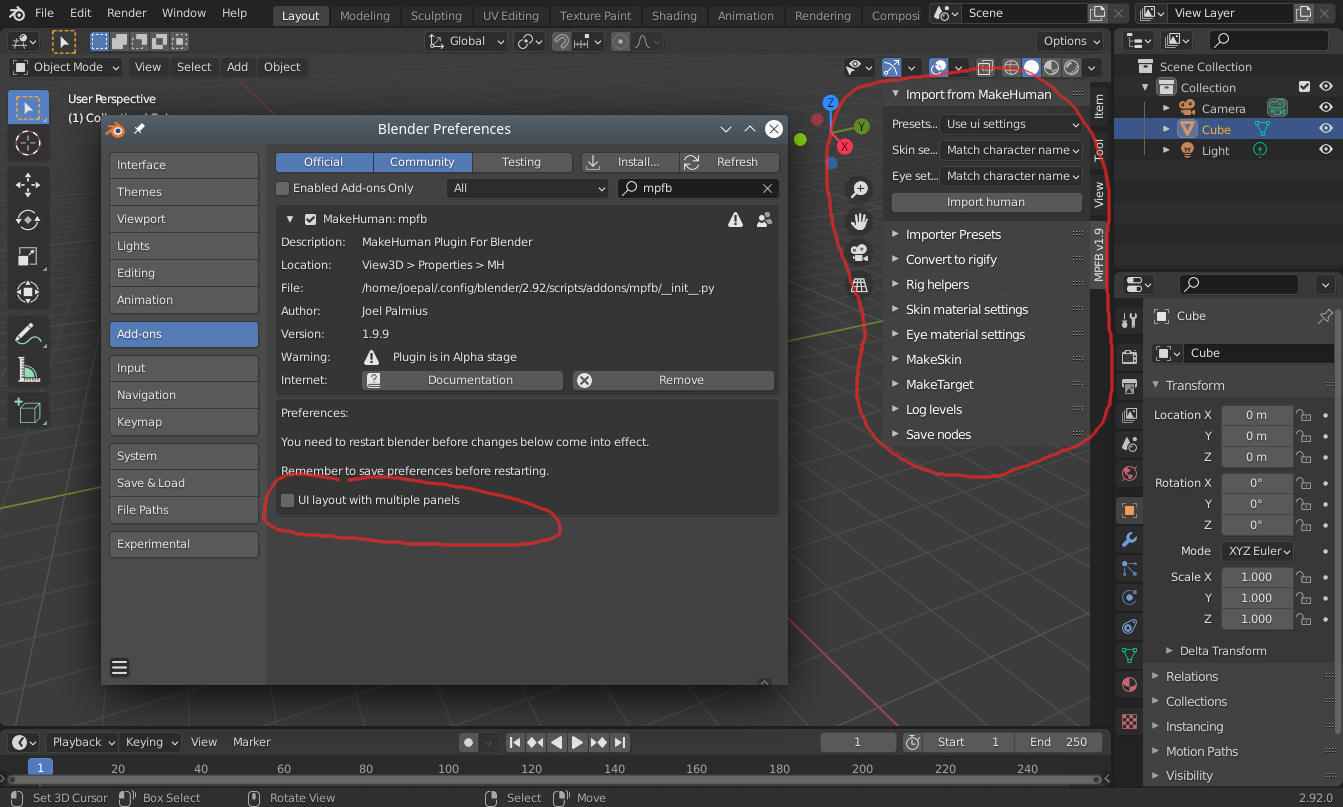

Postby tomcat » Mon Mar 22, 2021 3:55 pm
Is that correct?
Blender 2.92
mpfb2 download from
https://download.tuxfamily.org/makehuman/nightly/
plugin from github is not installing :(
Sorry for my bad English.

Postby tomcat » Mon Mar 22, 2021 5:13 pm
It's the same as in the picture above :(

Postby joepal » Wed Mar 24, 2021 9:46 am
I'm not sure I understand the problem.
Is it that it says "1.9" in the label?
Until MPFB 2.0 has been released as stable, we call it "MPFB 1.9.9".

Postby tomcat » Wed Mar 24, 2021 11:19 am
joepal wrote:Is it that it says "1.9" in the label?
No. Label "1.9" is no problem.
Multiple tabs in a panel instead of just one.
Posts: 576

Postby Aranuvir » Wed Mar 24, 2021 11:30 am
This will be addressed, sooner or later ...

Postby joepal » Thu Mar 25, 2021 8:07 am
There is now a solution for configuring this. It can be downloaded from github now, or from tuxfamily tomorrow.

Postby tomcat » Thu Mar 25, 2021 12:30 pm
Great! It's works.
It's a good gift for my birthday! :D
It installed after the second time. First time it gave an error:
