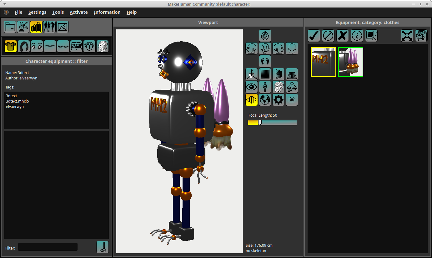

Here are some clothes, so a jet-pack, there will be more. This bot comes with the standard version, so it is "included" when you load it from github.
Clothes ...
Btw.: it might be more reasonable to switch off some buttons... like tongue, eyelashes, which that bot will definitely not have.

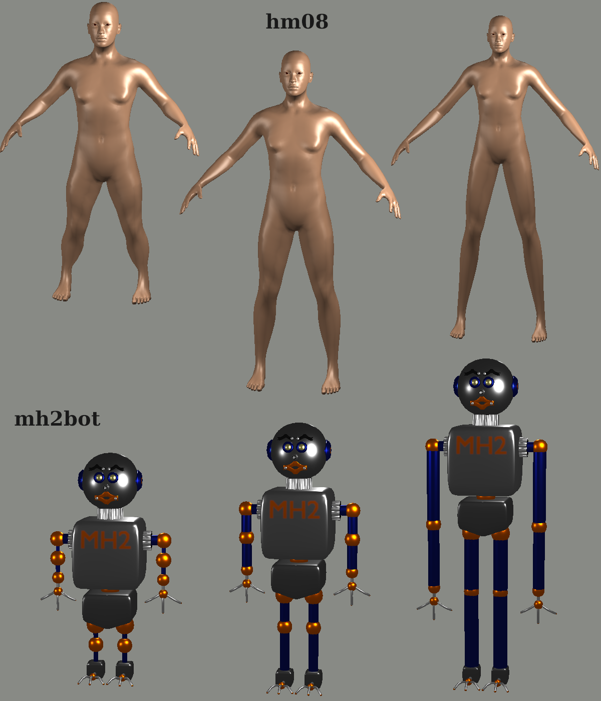

The assets were complete, but last time, I was not yet ready. A few meshes I got from Elv had to be changed to clothes and they needed small texture. Meanwhile the second example character, the mh2bot, is more or less complete.
Since the assets and textures uses space, more should not be uploaded to github, we should supply this later on our own file servers, if we will add textures and assets for the bot. Just to have a convincing examples and not just a uni-colored white asset I tried to do tiny 5k textures.
By the way, new makehuman can deal with small textures for assets with even a minimal texture size of 1x1 pixel. This kind of texture is internally used to create uni-color objects.

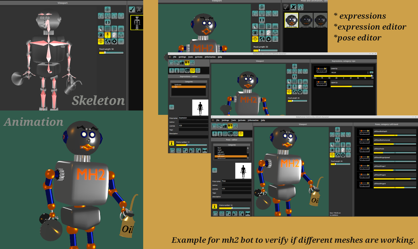

So meanwhile I figured out what was still missing to use the other menues in MakeHuman2 like skeleton, expression- and pose-editor and selection of expressions for a different character instead of the hm08 one.
The skeleton for that guy is simple. All weights are mostly 1 since one bone just changes one part of the bot.
Since that bot only has a few bones for the face, there are just a few examples in the expression selection. Expression editor only has a few sliders though. I also added one pose and a small animation. The pose editor itself is quite similar to the one of hm08.
It is not complicated to create extra sliders in both editors, it is done by body-poses.json and face-poses.json. There will be a description later how to create these files. You may have a look here:
https://github.com/makehumancommunity/makehuman-pyside6/tree/main/data/base/mh2bot
With the pose editor I created the overlay, that the guy could grab the oil can and the bicycle horn by changing the 3 "fingers" and the hands of the idle animation.
Menues for eyebrows and teeth will no longer appear, when a character is not supposed to have this equipment. Each individual base.json file now contains the asset-categories, so clothes, hair, eyes, eyelashes, eyebrows, teeth, tongue and proxy for hm08, for the mh2bot it is only clothes atm.

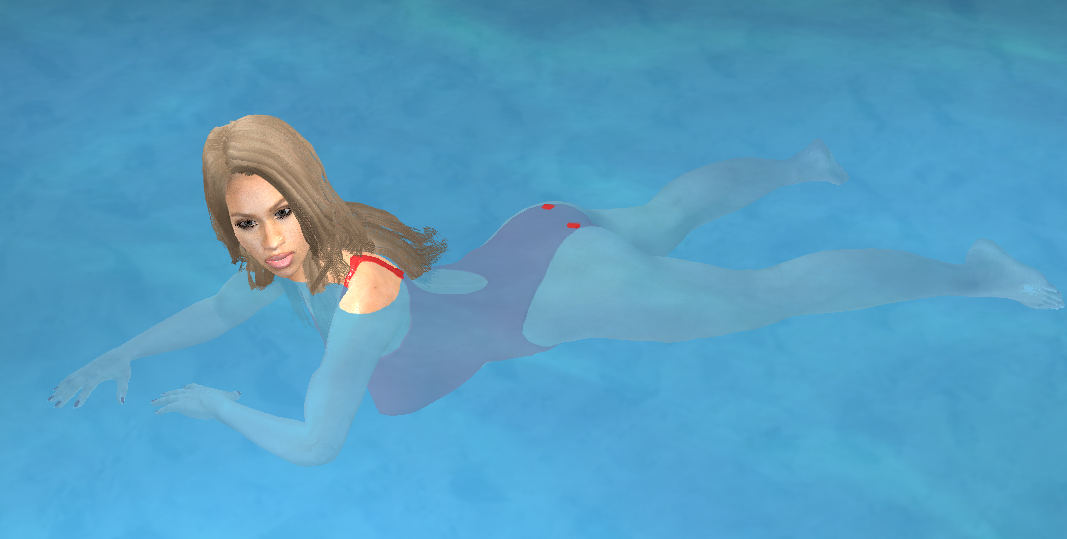

I am working on a few animations, which will be included as special assets for makehuman version II. Therefore I changed the floor, which was mainly used for debugging of walking animations.
It can be resized now and also made thicker. When transparent the floor is useful to simulate water. So one can create an origin for a later animation to be below the floor. It is not yet 100% but the animation itself looks pretty good. A few different skyboxes and floors will be available as assets as well.

Postby Ricardo2020 » Sun Sep 07, 2025 3:12 pm
This is mighty nice in terms of the way she moves through the water, the way the bones of the rig move. Very realistic, indeed.

Well the water surface is just for determination of the origin of an animation. It is not meant to be a new Blender. Maybe you remember that there is mostly a "feet on ground" checkbox for the exporters. For swimming this results in an odd position (it is not really feet on ground, it is more or less the lowest vertex). I will try to have at least one pipeline to export to Godot/Unity/Unreal via glTF without the need of using Blender in between. That is e.g. the reason why I switched to more common textures like metal-roughness and AO map at the moment, these ones are used in game-engines. AO map in Blender does not make too much sense, at least not in cycles.
