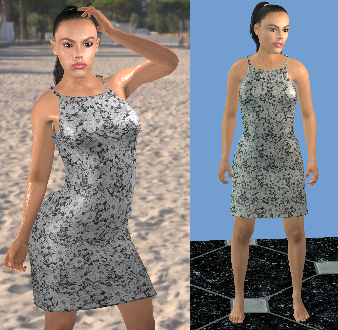

As an example I now change my fashion pose inside makehuman that my character really touches her head, and also the sub-divsion algorithm (only used internal in a kind of renderer for those without Blender or other software) is now mostly working. One of the problems has been fake-seams generated by wavefront import (identical UV coordinates where no seam is). The weird thing with that Charles Loop algorithm is, that they all give the examples without textures ... and the real seams are a problem, since you always need one vertex on the other side of the seam :shock:
posing and subdivision

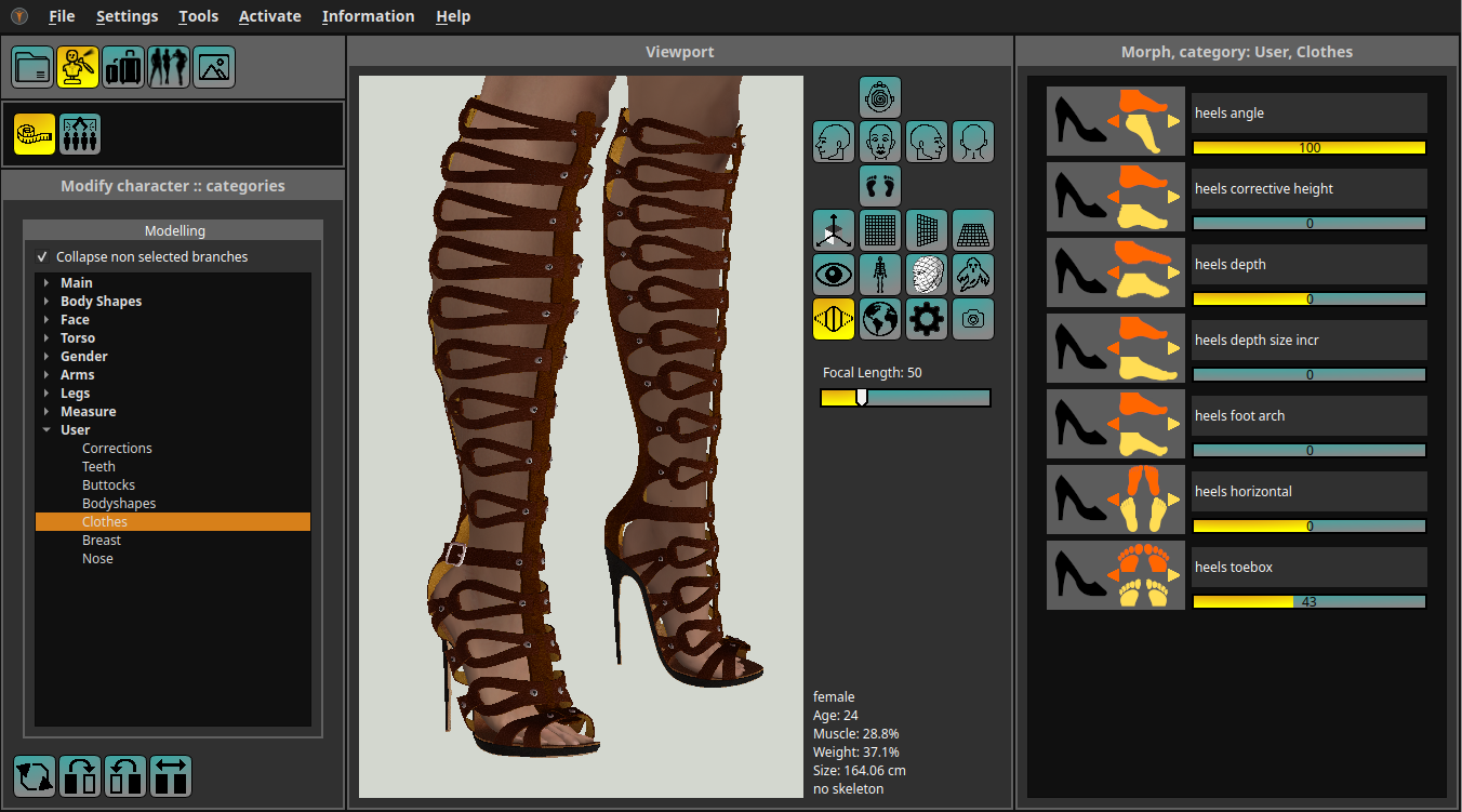

Furthermore an example of a custom folder of targets. Btw. these targets also work with old makehuman. But this way it looks more seamless and one also can add own icons + incr/decr targets also generate only one slider with a "middle position". Simply done by using correct name patterns. These own targets can also be compressed to binaries (like the internal ones) to load them very fast. The character animation of walking even work with these shoes. Unfortunately she walks a bit slow. These shoes have a lot of geometry ;)
custom targets
