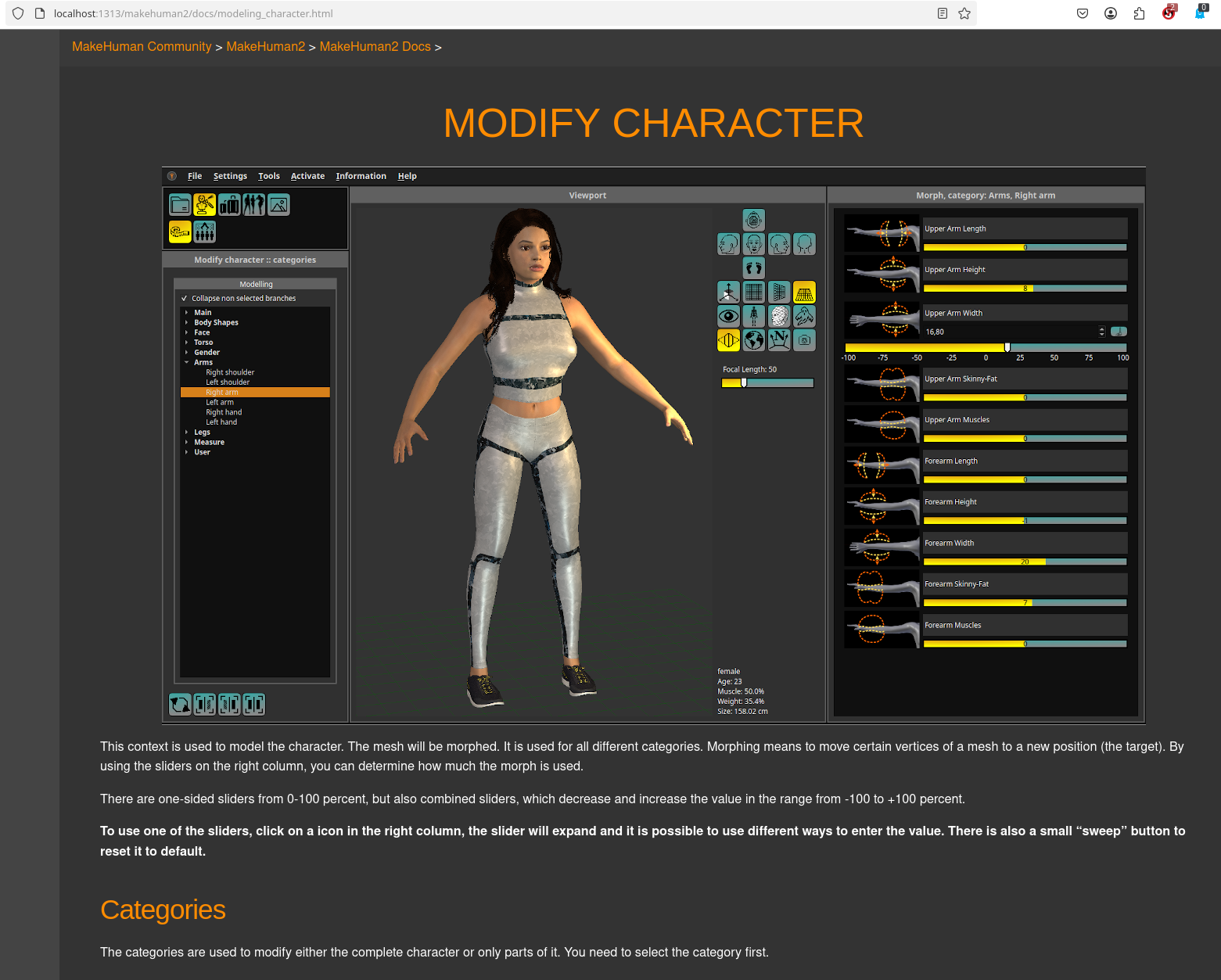

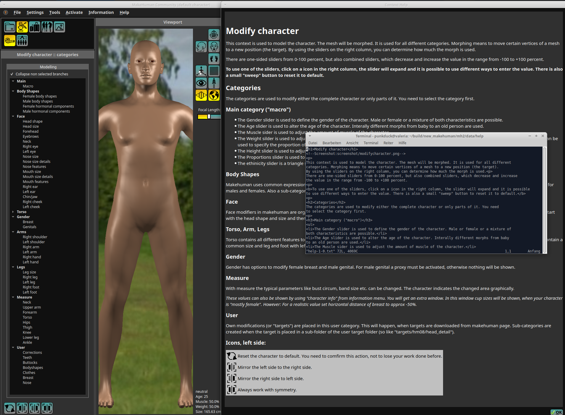

I tried to add a context help and since I am lazy in documentation I did it in a way I do not have to write it twice. One time inside MakeHuman and one time in our "static page". So I started like this:
context help, each screen will also present a context help
When one presses the help button in the menu a context help can be displayed. PySide6 understands a bunch of html commands, as you can see in the black editor window. So <li> for list and <h1> for headline type 1 etc.
It even understands tables (not very beautiful though) and can display images (which are somewhere reachable). So for an inline documentation I think that is pretty good. And for Hugo?
Well as you may recognize HTML comments are skipped (the line starting with <!-- and with the screenshot) when displayed. So this is my helper for additional screenshots in Hugo, since a context of course is missing and without a screenshot the documentation in Hugo would be hard to understand. Hugo is not HTML, it is a markdown (dialect?) ... so I needed a converter. I did a quick hack and changed markdownify on my box to first replace the comments with <img> commands and then convert this HTML text to markdown language. Markdownify internally uses "beautiful soup", an HTML analyzer. I guess I will strip that program to our needs in the end or rewrite it. Nevertheless I got this result after putting icons in one folder and screenshots in another:
after conversion to markdown

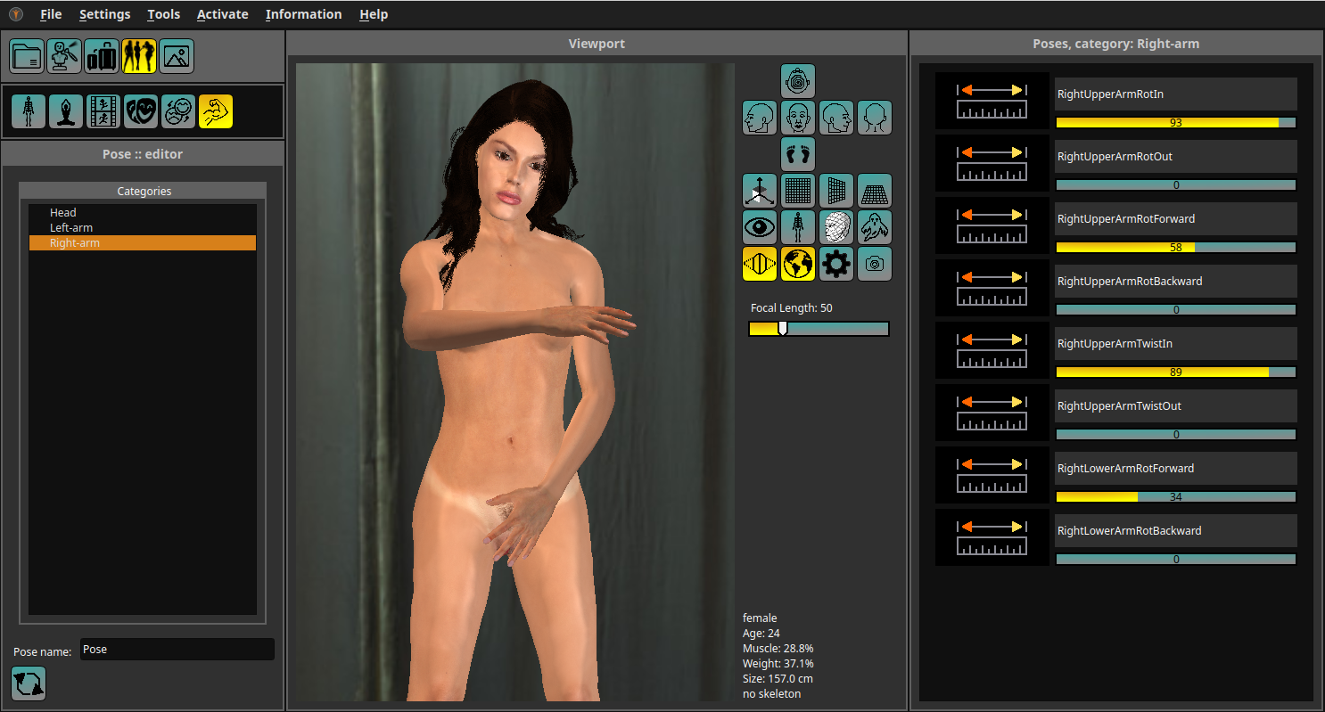

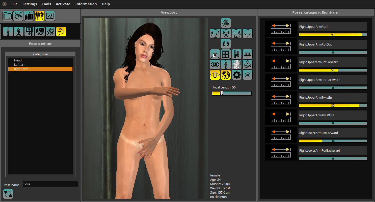

I started with a way to animate the character inside MakeHuman. I decided a way similar to the expression editor. It should apply for at least 2 purposes:
  • Create own poses without blender or other software.
  • Tweak animations. Especially when e.g. hands intersect with body it was mostly annoying in game engines.
So an example with only head, upper- and lower arms working. At least I can do my own censorship already :lol:
hide nudity :)

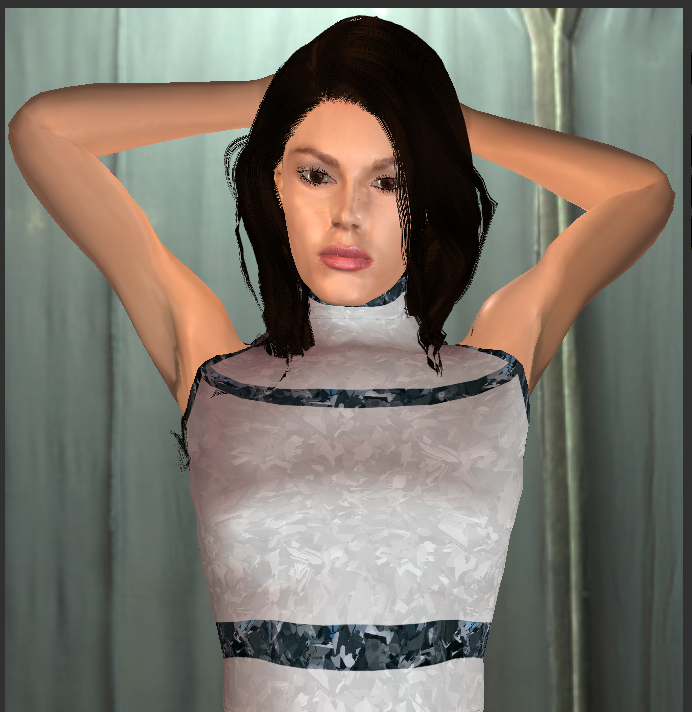

And I tried the "arms behind head pose". Not yet 100% convincing. But for a 1st try also not that bad.
one of these terrible poses I always hated
Another example: meanwhile my PBR shader reflects the environment (I use that only for metal, although it would be not incorrect for a "wet" character as well). I will create sliders for hand + fingers next and hope the sword will then "kinda work".
arms okay but fingers not yet
Next step I will try to work with sliders with "mid-position" (head turn left + right is not that perfect, "head turn" would be easier for the user). And then saving + loading, when I leave that editor all is gone. It is an own format. using the matrix poses we use internally when we e.g. create an expression, so not bvh. It would only support scaling and rotation. The only bone in our skeleton not being fixed to a relative location is the root bone. Not that good for e.g. jiggle bones which can start from a different location. And then I need to figure out how to overlay or replace an animation. It will be pre-calculated, I allready do that, when I switch off face-animation. When my wonder woman is able to walk without hurting herself with the sword, then that tweak method should be okay :lol:
Some bugs are fixed. But I will create new ones :roll:, do not worry.

Postby tomcat » Sat Apr 12, 2025 10:14 pm
I believe this problem should be solved in the game engine. Even if it is done in MakeHuman, it is unlikely to transfer it correctly to the engine. Which one, by the way? Engines are not standardized and what will look good in one may look terrible in another.
How convenient, in general, to create animation in MakeHuman? This is a completely different specialization of the program.
Here it is necessary to connect the movement of the bones. I suggest leaving this problem to the game engine.

I tried to import the characters to Godot and unreal. Since formats like glTF and fbx are standardized the result is not that different. Godot was quite similar to the blender output, But there I needed to add the animations myself just from the beginning.
Whereas Unreal looked terrible in the beginning. The reason was, because I thought the internal game skeleton is a must. Especially because of that default mannekin and some animations, which I wanted to use. And that is, what most people do. Either taking animations from Adobe or trying to convert that stuff. And I understand why people do that. I tried a few without this. It takes some time ... and most people do not spend a lot of time for that.
Later I used our skeleton and my own animations (like I did in Godot with the standard skeleton we use) and it mostly worked. Limits are weird effects when a rotation cannot be calculated directly. Or for all: quaternions flip back and do no pirouettes (so root bone should always be Euler, quaternions are -180 to 180 degrees normally) :lol:
And then there is another problem. Our body is weighted and the weight transformation to another bone-set is not always the best (simply because of mathematics). And these weights were used in the engine. In one of the Sim-Worlds the system created own weights. This could be a catastrophe for obvious reasons (it is simply a distance algorithm). A character sitting cross-legged looked weird.
The reasons are sometimes bone-axes but also unfitting sizes. The game engines use preferable fast skinning algorithms (this is needed for speed). A few techniques like game engine skeleton as a driver skeleton + extra bones to keep distance of skin like in Metahuman help, they simulate fat or muscles (and if you change bone-length these muscles might also do some effect). But the skin has to be weighted to these extra bones. Otherwise the bones are simply useless.
Without changing too much, in Blender there is also a method called "keep volume" or more correct: "volume preserving mesh skinning". What works fine for a twisted lower arm is a catastrophe for that arms-over-head-pose, it creates a body-builder. Mindfront did that and I did that, too, but only in Blender.
The reason for an own editor:
1) I created a lot of animations in Blender and sent them to Flute to help her. It was an idea to help these people in future who neither want to use an extra program like Blender nor do want to play with the character in a game (engine). When I started MakeHuman years ago I was not really happy, when I saw that the character was glued in A-position.
2) Our bvh files mostly had problems with arms intersecting etc. This could be fixed easily with just tweaking the pose a bit. And then a beginner has a more healthier character :mrgreen:
3) The code is nearly identical for expressions and poses. I create a common class and added two inherited ones which are more or less only super(). calls with a parameter here and there. Most is not programming, it is creating poses in Blender for the sliders, which yield in 3x3 matrices (saved as a vector) in a json file. It is easy to maintain, compare to the old face-units.bvh we had before :roll:
https://github.com/makehumancommunity/makehuman-pyside6/blob/main/data/base/hm08/body-poses.json
There will be a few methods for symmetry (like we use for targets) later.
Honestly: using the expression method also for the body is not that bad. I did the following image as a test today, For a single pose (only head, arms, hands and fingers work atm) it is okay.
