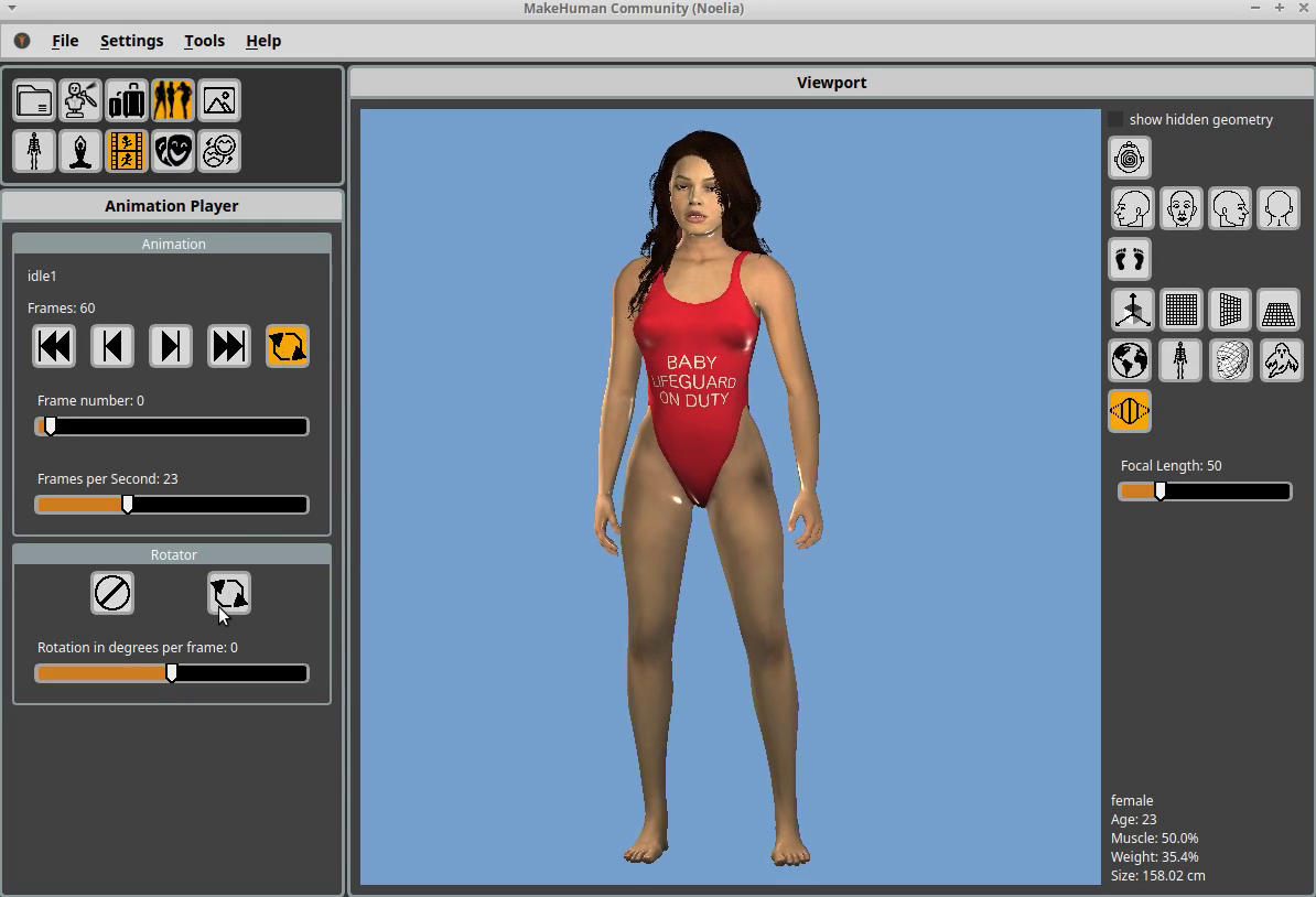

Postby punkduck » Tue Nov 26, 2024 9:40 pm
Of course I created the most unimportant thing first, a rotator.
The reason: I was never able to see the litsphere textures really working (it is a kind of image based lighting).
So now I rotate the character in the animation view and it also can display the animation itself.
In most games idle, walk and run movements are added. So I did an idle animation for the makehuman skeleton. It seems to work. Real ones for game-enignes usually are different to start a walk movement seamlessly. Usually one foot is moved forward a bit, the other backward.
Here is a small demo:
noelia_idle.mp4
60 frame idle movement
(6.27 MiB) Downloaded 13463 times

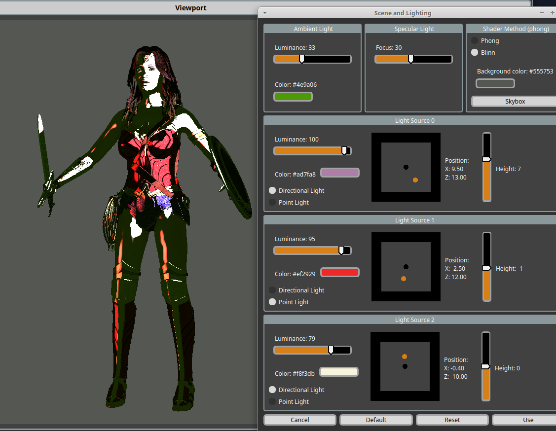

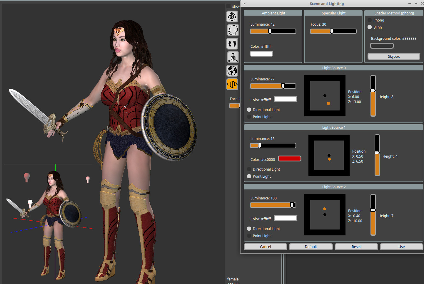

playing with the toon shader
The old toon shader either uses the litshere lit_toon.png (and so it is not an own shader) or we have a second one, called toon shader itself, which calculates the normals and one of the internal light sources in MakeHuman.
I took the old code and, more or less figured out it is a phong shader in a way and adapted it to all 3 lights I have (one can switch off 2 lights to get the same result we had before), then I took one of my test characters and changed the lights to get some artificial results. The example is shown in the image. When the character is animated it looks even better :mrgreen:

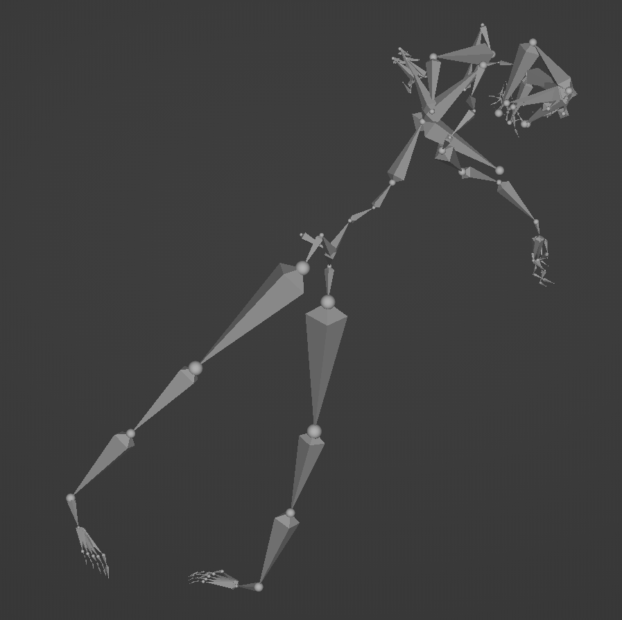

old makehuman, BVH export
This is the bvh import exported by old-makehuman in Blender. The new one looks also wrong but not that wrong.
Honestly, how is that supposed to be? The skeleton definition inside bvh cannot solve the problem. Does anyone of team know how a useful test of the bvh exporter looks like?

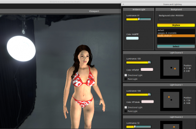

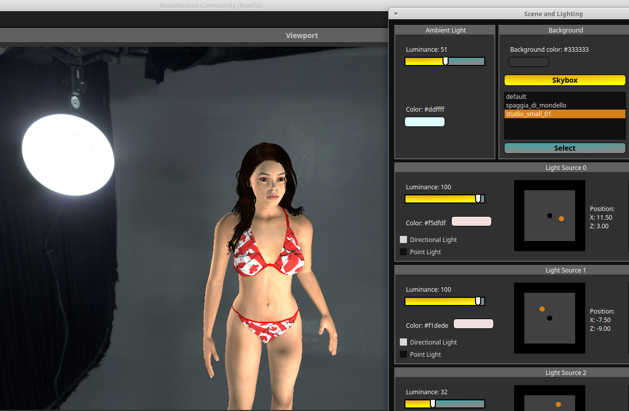

Except from that bone-pretzel I made the skyboxes/cubemaps now configurable (it should be used for reflections later). One can use converted equirectangular environment maps, It may look good, when things are far away, but the idea of using a small studio demands a fish-eye lens.
This looks okay:
a well known environment map transformed to a cubemap, big distances allow reasonable focal angles
This is the only possibility to use a small room as a skybox.
studio, 15mm fish-eye
For animation the skybox can be rotated as well. One can switch it off to avoid nausea (not a joke, I reduced speed to .25 degrees per frame, even 1 degree was a bit much) :mrgreen:

Postby RobBaer » Fri Jan 03, 2025 11:07 pm
@punkduck
It has been years (probably since Duststorm was still around) since I played with bvh in MH. One of the things I never got straight in my head is that pose files use the order:
CHANNELS 6 Xposition Yposition Zposition Xrotation Yrotation Zrotation
Most .bvh files from other sources like the carnegie collection use:
CHANNELS 6 Xposition Yposition Zposition Zrotation Yrotation Xrotation
or for people using Kinect based NUICapture (http://nuicapture.com/) stuff seem to use:
CHANNELS 6 Xposition Yposition Zposition Zrotation Xrotation Yrotation
Parsing order is presumably important, and I haven't looked at the MH code to see if it is robust to file order, but this seems like a possible problem that could be causing what you see:
https://stackoverflow.com/questions/526 ... 8#52699028
and
https://research.cs.wisc.edu/graphics/C ... f/BVH.html
The first post above also talks about needing both the HEIRARCHY and MOTION data to get axis alignment, and provides an example of what happens with just HIERARCHY data versus both.
I also have a distant memory of trying to fight through some bone-roll issues related to .bvh files, but the details are gone.
Finally, I'm including two .bvh files that look fine in blender 4.3 and used to work with makehuman using makewalk plugin in the olden days. Perhaps they will be useful to you. One of the files is an original file from the carnegie collection; the second is the same file after import into Blender and export back out of blender. A quick look makes it seem that it made the Blender Import/Export trip unscathed. Note that the order is:
Hope maybe one of these provides a clue to unraveling your problem.
