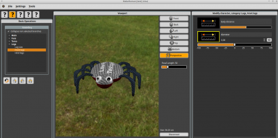

Not only humans are possible, in theory all other objects as well. No need for only triangles or only quads. Although good base meshes usually are quads (reason is that subdivision usually looks better). The base mesh can be placed in user space as well.
(Sorry my art is just crap it should be only a demo). OpenGL does not have quads anymore (since years) ... so I invested a long time to rethink that (triangulation etc.). Perspective can be used as well (there will be more like grids etc. later).
And for all Vulkan lovers: Vulkan and OpenGL use more or less the same shading language, but the shader pipeline of Vulkan is more efficient. The technical possibilities of the shader is limited by your card. So I tried to first understand the background just not to be part of a discussion with no technical knowledge at all (okay these people now discuss AI :mrgreen: ) . Maybe I will change that in future but atm I don't see any reason to do that. And for me Metal is a music style (I also like), not a shader. I wonder that apple thinks being proprietary is a good idea after using a UNIX like filesystem which allowed me to even put a lot of Linux stuff on a Mac. I left Apple when they want to know what I do with my box and had to be registered with my real name. For windows I cannot avoid that but no Windows version is a no-go.

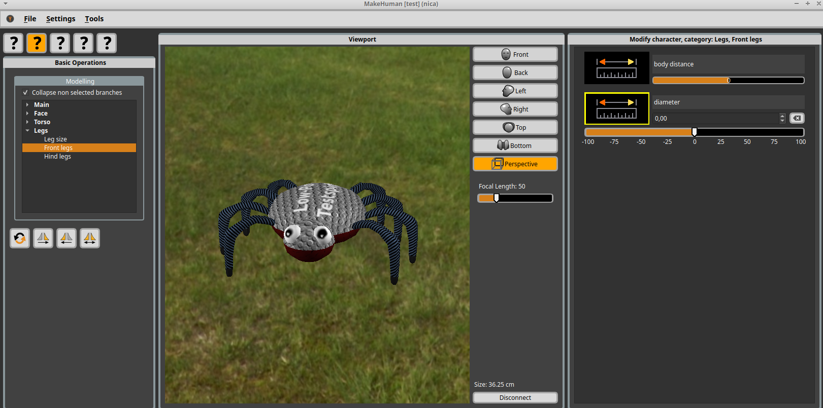

better sliders for exact modelling
A lot of people wanted better sliders .. here is my version, which saves space when not activated but also can be used with 3 different methods when changing a target.

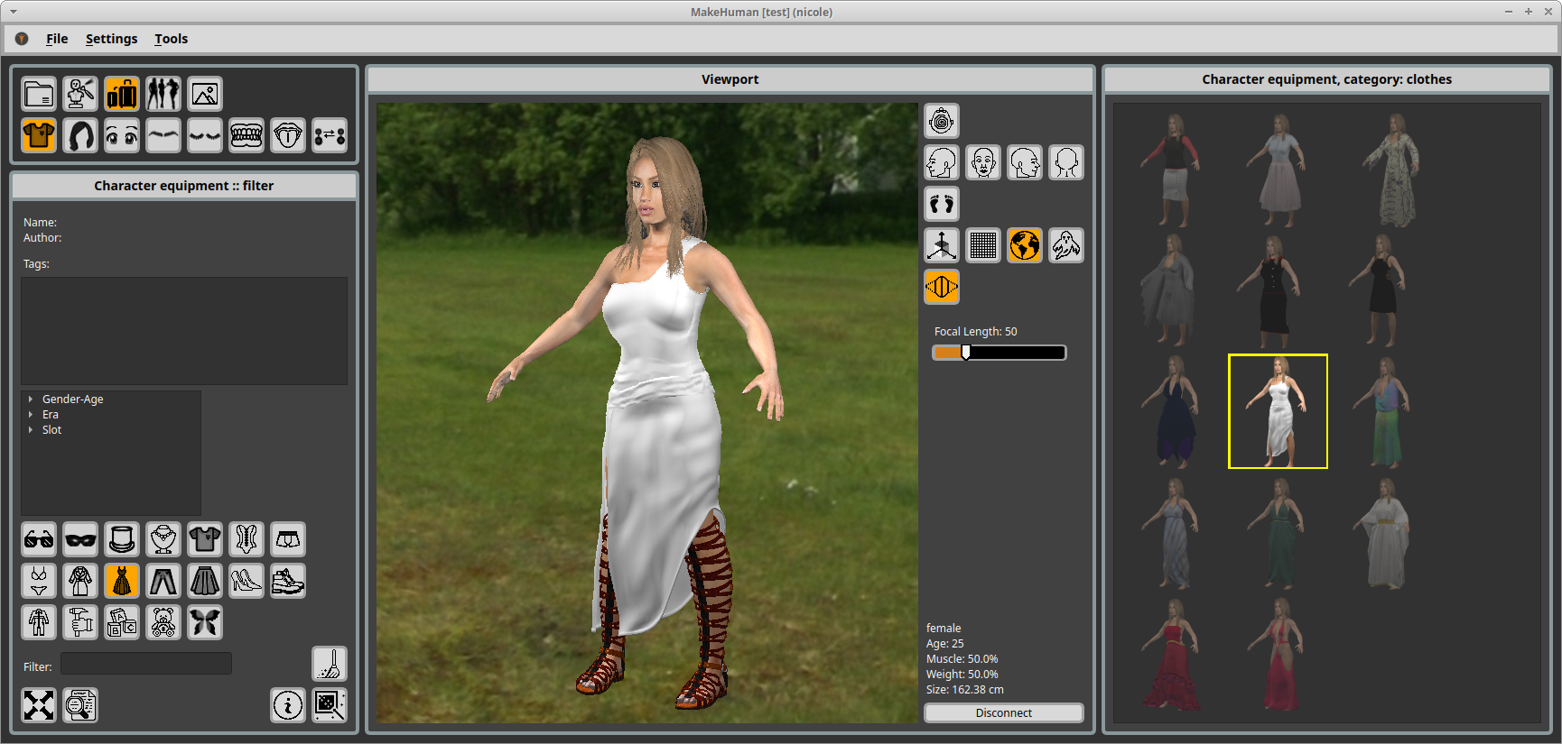

I just started with the repository ("equipment"). A new filter system was added, the tags are partly recalculated with an algorithm and author and filename are added ... which allows a simple search as well. Shortcut buttons to reach the tools are in "production" ... reason for the '?' buttons.
she certainly needs clothes

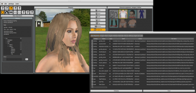

As an old fashioned C programmer and someone who wants to know what I use and for debugging there is an Info tool included, which shows, what is in use or known to the program including path names. No excuse anymore for all those who do not understand their own filesystem. :lol:
Okay. We will open the repo, when more is visible and the system is more stable. It is not easy and there are a lot of drawbacks. Especially the technical approach to add new features + ideas and make it compatible to old one is a challenge.

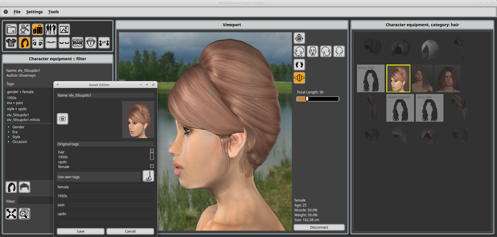

Meanwhile I added a small asset editor which allows to change tags (create own tags which override given ones) and do a thumbnail for assets. Information of own and original tags are no longer in "filecaches", I use sqlite (which is "included" in python) for that.
With this editor I now get this view, when I use a filter for dresses:

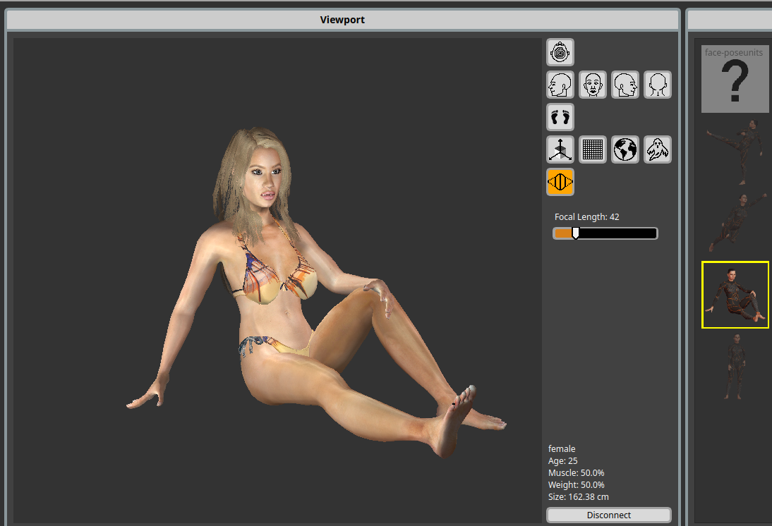

I started with skeleton and skinning.
Trying an animation with MakeHuman ... I tried that with existing version of MakeHuman, but always saw only the last frame after some time. QT will not refresh the view. The correct way is to use a cyclical QTimer() which should then paint the frames.
In the example: My walk cycle is just a quick "hack" derived from a bvh made for a different skeleton and the cycle was not really a good ... but it is working. It is still slow, but better than I expected for a first try
