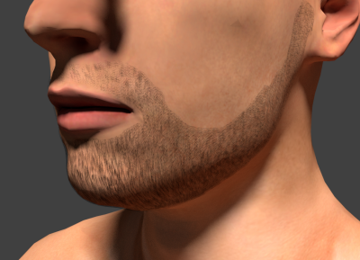

As a very quick not good example at all as the beard is floating off of face slightly i rendered a plane that i made transparent with hair particles, saved this image, then take my human duplicated the beard area and assigned this new "hair texture" -
Hair texture is transparent and black hair so might not show up here.
